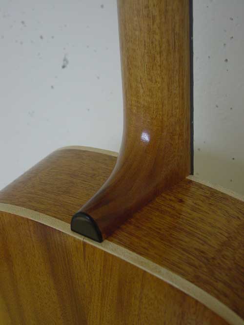

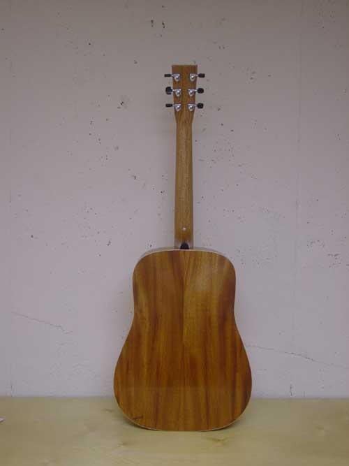

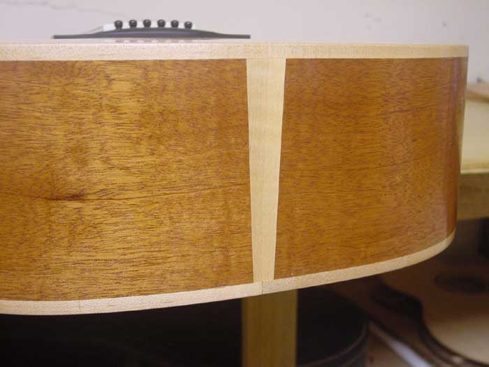

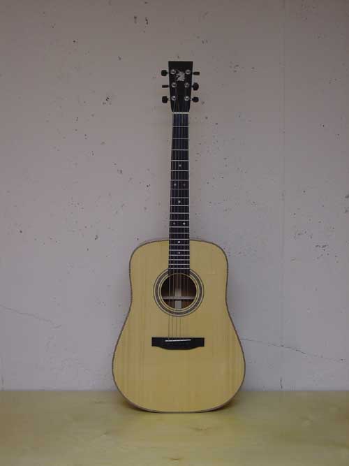

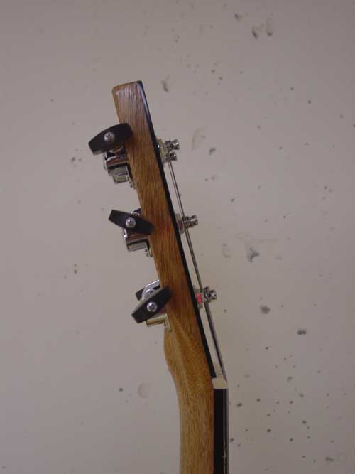

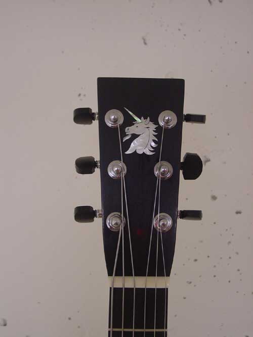

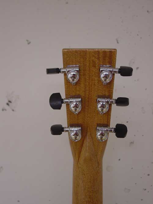

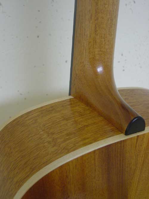

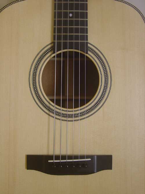

Hello All,
I would like to thank EVERYONE for their help in getting me through the building of my first guitar!
I have learned so much from all of you, and, learned some things about myself too! It has been
sort of a long journey, but, well worth the time and effort! In fact, I’m looking forward to starting my next soon!
I’ve got my new shop all set up, and lots of good zoot I got from the swap meet.
Anyway, hope you all enjoy the pics, and please feel free to comment. Any and all criticism will
be welcomed with an open mind.
I’ll try to answer a few questions you might have right away. Sorry about the quality of the pics.
1. It’s a Stewmac Dreadnought kit, and I should say it was a very fine kit to work with! I would
recommend it to anyone who is contemplating their first build.
2. Top is Spruce.
3. Back & Sides are mahogany.
4. Neck is one piece mahogany.
5. Binding is quilted maple, with herringbone purfling.
6. Grover tuners with ebony buttons, that I got from Mr. Bruce Dickey.
7. Strings are light, flat wound, and they feel real nice.
8. Ebony peghead veneer, and fretboard with MOP dots.
9. Finish is True-Oil, (4 coats)
10. And, what I think is the coolest part! An inlay done by Mr. Paul Bordeaux.
BTW, the guitar sounds fantastic!
Thanks so much, again!
Robert
Thanks for looking!
Robert

NICE !!
I love the inlay-Paul does great work.
Did it take long for the oil finish to dry?

Neat, clean work, with simple design executed well! I can imagine that inlay was a little tricky to accomplish.

Very nice job, Robert. It looks VERY clean.
PostPosted: Sun Jun 03, 2007 8:17 am
Very nice first guitar! Very nice guitar, period. I like it.
Ron (on the road)
PostPosted: Sun Jun 03, 2007 9:08 am
Real Nice first!
PostPosted: Sun Jun 03, 2007 10:06 am
Posts: 698
Great work Robert. Classic looking dreadnought.

It take some guts to have Paul do some of his fine work on your 1st guitar.
I would have been to chicken to have him inlay on my 1st just in case it
didn't turn out OK

That's a fine guitar Robert. I like the lustre of the Ture-oil finish. I'd be interested in know how it holds up as a finish. Well done!

Looks good, Robert!
Glad it sounds good, too.
I bet it would sound even better though, if you put some bronze strings on there.

Great work Robert . The volute is very cool, as is the whole guitar .Did you seal with a shellac first coat , or put it straight on ?.

Mike, they suggest (LMI) you wait about 1.5 - 2 weeks for the final coat to cure before you do
your final sanding/polishing. I waited, I think about 9 days, and it turned out just fine.
I applied all four coats within four days, lightly sanding with 0000 steel wool between each coat. It’s about as
easy as a finish can be to work with. I did not apply it exactly the way LMI suggested. I poured a
little on a clothe, then wiped it on the wood as lightly as I could. (It was stressed that, you don’t
want to let it soak into the wood). The first coat seals it up pretty good, so, you can be a little
more liberal with successive coats. At least, that’s what worked for me. I will say, that it takes to
hardwood a lot better than spruce. Next time, I’m going to apply more coats, but sand more aggressively
between coats on a spruce top. Also, for the final sanding/polishing, I started lightly with 400 grit,
then went right to 6000 grit Micromesh in circular motions. Followed by 8000 grit,
then finally, 12000 grit. Here’s the address if you want to read more about it.

Sam, thank you! Actually, it wasn’t very tricky. Paul did the inlaying for me. All I did was glue
the veneer to the peghead.

Isn’t anyone going to ask why I chose a unicorn?

One day while working on my guitar in the old shed, I got to thinking,
I‘d like to do some kind of inlay on the peghead. I thought, my name.
My initials. My boys name. Combination of my name and my boys name.
Well, you get the idea! Then the proverbial “light bulb” went off over my head!
Which doesn’t happen much anymore, due to the loss of voltage in my brain over the years.
Anyway, there I was, just standing there, staring at the peghead, when I said to myself!
Hey! I wonder what’s on my family crest! So, to the web I went! lions were everywhere.
There were deer, eagles, boars, dogs, and all kinds of emblems. When I came across mine, I said “hmm”
that’s sort of unique! A Unicorn! And, not just any old bright eyed, bushy tailed, with long eyelashes,
and kaleidoscope colors unicorn. This unicorn was Bold, Proud, and Brave! Not that I resemble any
of those characteristics. However, some Dobbs in the past must have. Course, in those days, it
was real popular to be bold, proud, and brave, along with a large serving of chivalry.
So, in respect of my forefathers, I shall carry on the tradition, and proudly inlay the noble unicorn
on my guitars! (Since I don’t have a shield or a sword to weld around) And, if I’m fortunate, they
will say to themselves. “Robert, my that inlay serve you well!”
